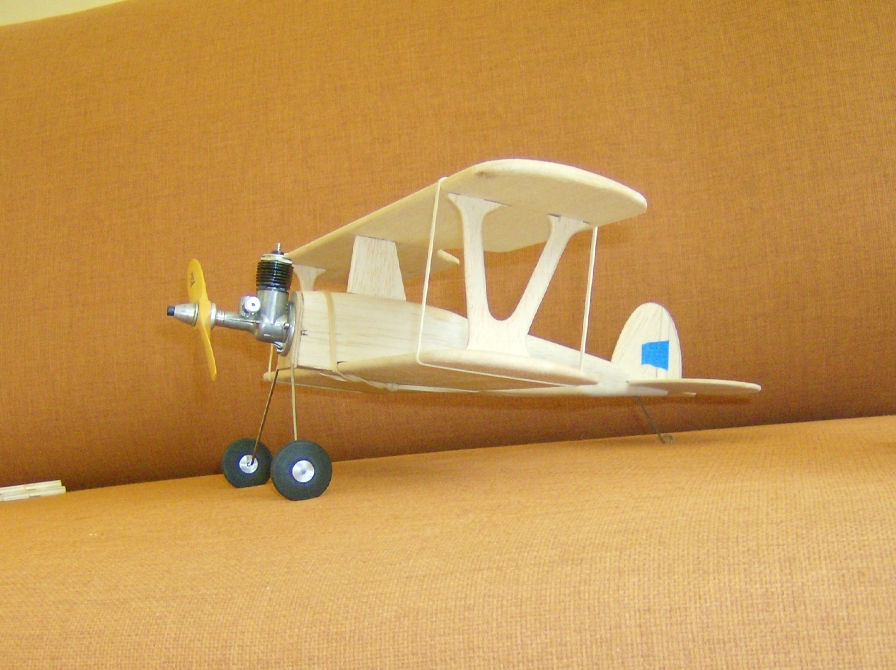

« Reply #8 on: April 01, 2022, 07:07:59 PM »
Hello Guys
                              Gordon Van Tighem came thru with some photos that are going to be very helpful as I`m trying to do a little bipe like it looks on the artwork in the kit box. They show details like the wing struts, position of the cockpit and they show that there is a cabane strut on the fuselage holding the wing at the center. I was guessing that there was a strut needed to hold the wings at the center and made one that doesen`t look like the one on Gordons model. I`m really thankful for Gordon`s photos. The last one is of the bipe that I`m making. here they are.

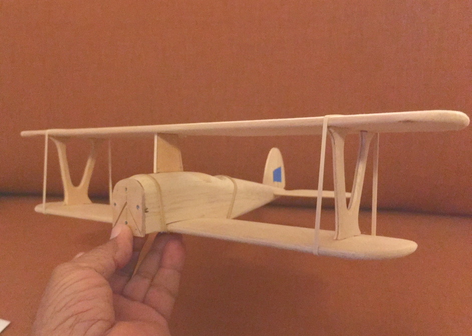

Re: Scientific Little Bipe first version
« Reply #9 on: April 15, 2022, 05:51:26 PM »

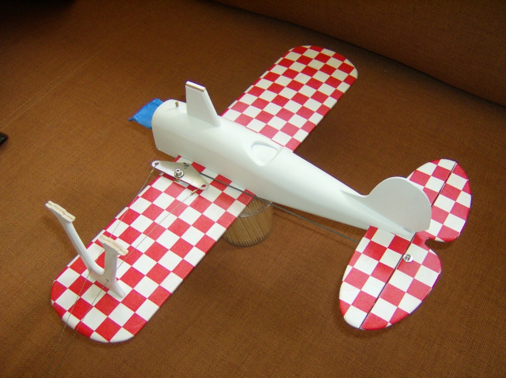

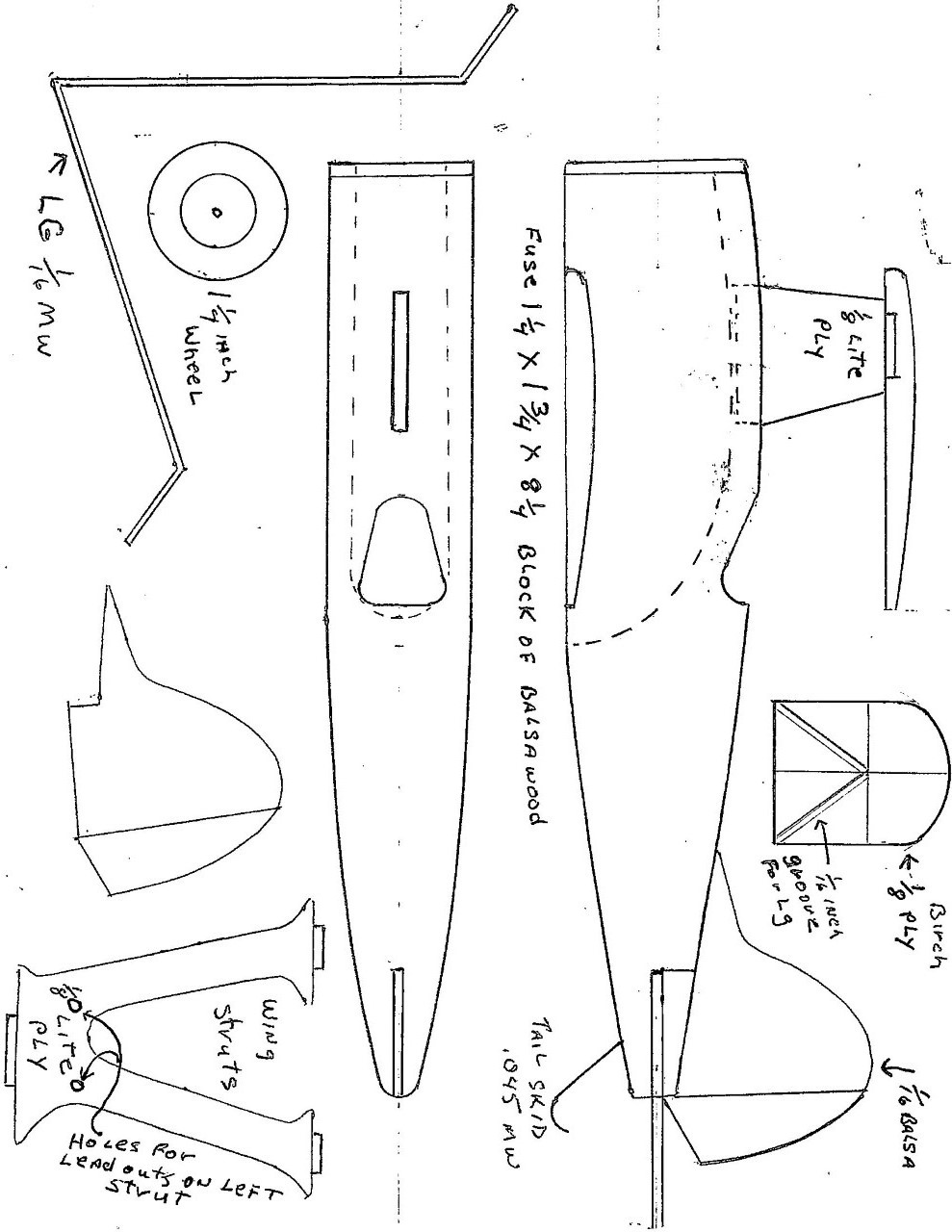

                          I did a little more work on the little bipe.  I made new V wing struts and added a cabane strut. Haven`t been able to do more work due to power outage and health. I also have been doing a couple of PAT-1 by Bill Netzeband which was my first balsawood as I was moving from cox plastic P-40 to fly with my cousin`s son. here are a pair of pics.

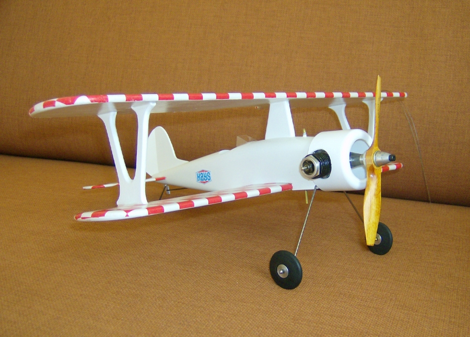

« Reply #15 on: April 17, 2022, 03:50:47 PM »

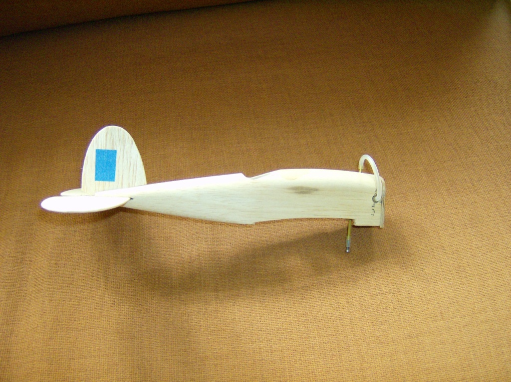

When I saw that second picture in the post above, I thought, "Why does he have such big wheelpants?!?".
« Reply #16 on: April 17, 2022, 06:06:57 PM »
                  Hello Mark
                                        They are hollow log fuselages but I found your comment funny.

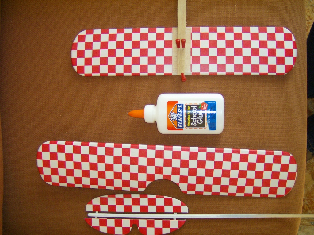

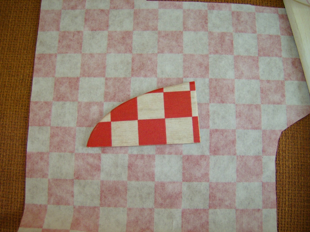

« Reply #18 on: May 16, 2022, 06:01:31 PM »
               Since I`m not good at using plastic film and locally it gets hot and plastic film will sag I started painting the fuse of the little bipe. After a few coats of clear dope with some talc I decided to use Transtar 4633 white primer and I`m sanding the primer until I star to see the wood thru it. I have glued the wing cabane strut and the rudder. I like this primer and do my sanding dry with 400 grit sandpaper it powders real good. After sanding I use windex to remove sanding dust before giving the fuse another coat of primer and again I sand until I start to see the wood thru the primer as I want to fill the grain of the wood but remove as much of the primer as I can. here are a few pics.

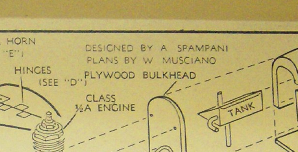

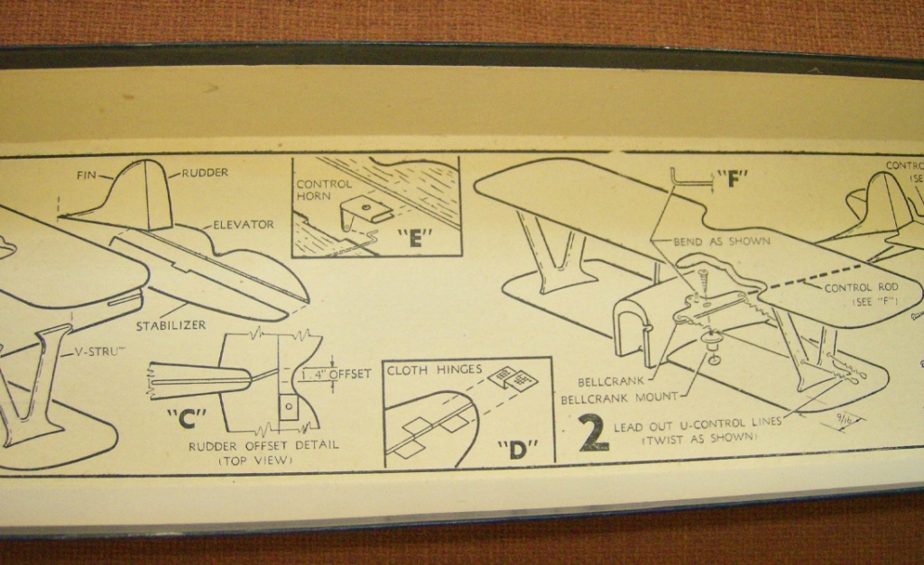

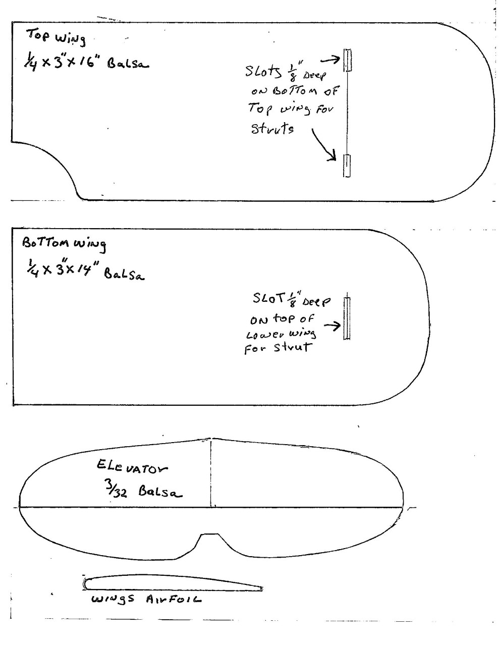

             I received the Little Bipe Box and here are some pictures of the instructions on the top of the box in case someone want to build one. The little Bipe first version is an Aldo Spampani design and the plan by W. Musciano

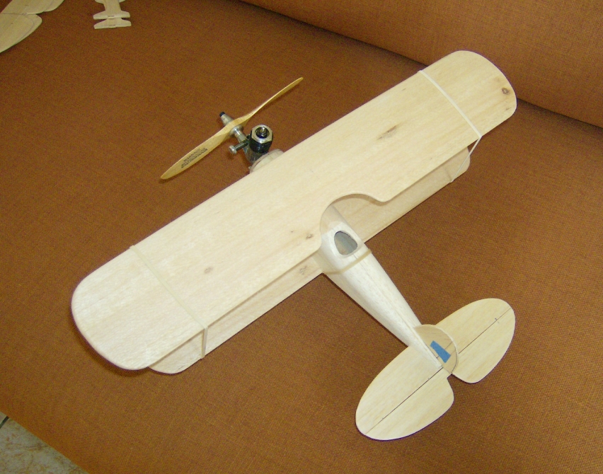

               I had not being able to work on my little bipe model due to health issues and lately I have done a little work on the project. I painted the fuse,wings and tail feathers white with the idea of covering the wings and elevators using some checkered paper used on the basket used to serve sandwiches at a local cafeteria. The paper is red checkers on a thin white translucent paper. At first I practiced applying it to the wood brushing Pactra clear dope but the red ink would run and smear the white portion of the paper. Then an idea occurred to me and I decided to try gluing it using Elmer`s white glue. I used a damp paper towel to wet the underside of the paper then I applied white glue to the surface being covered, Using a playing card as a squeege I removed the excess glue. I placed the damp paper over the surface and with a playing card I gently removed air bubbles and got rid of wrinkles. Once the wing surface was covered using a small paint brush I applied glue to the trailing edge and leading edge working the paper to follow the shapes. I did the wing tip last working the paper around the edge which left me with some small wrinkles that I will be removing with sandpaper once I give the wing enough paint coats of clear dope. I`m letting the paint dry before I apply more coats of clear dope. Here are some pics.

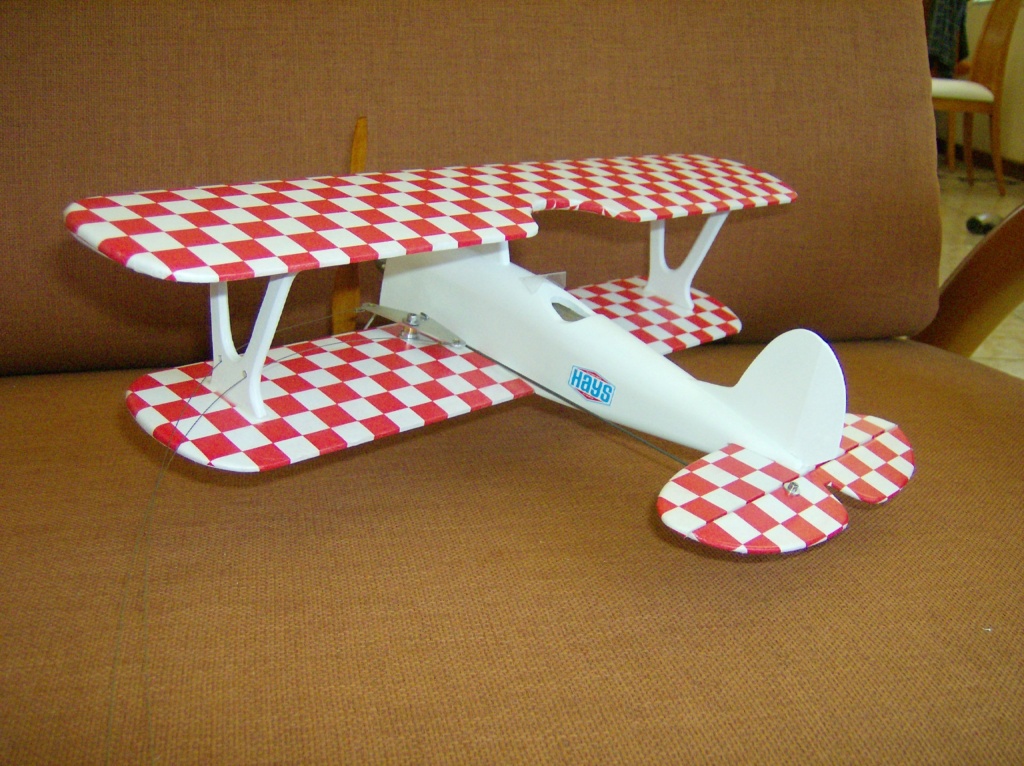

« Reply #25 on: July 14, 2022, 12:26:44 PM »

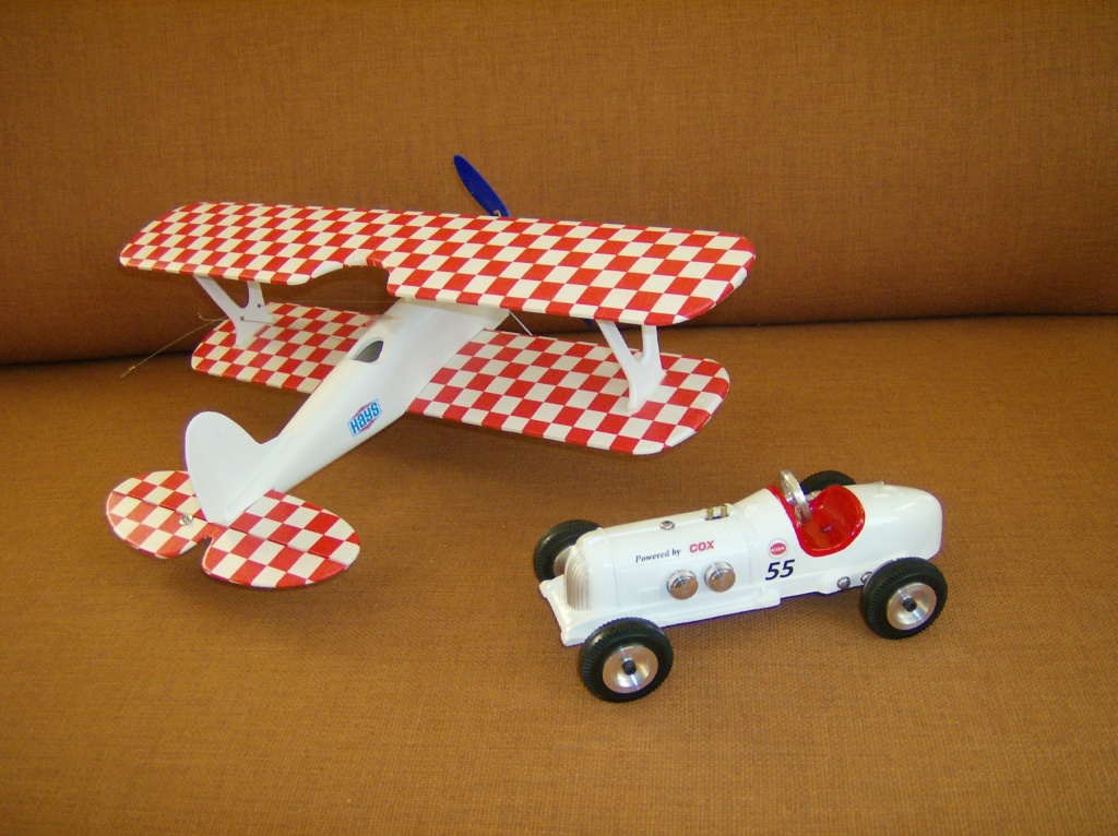

                     I have done some work on the Little Bipe. Painted fuse and wing struts and also gave them a clear butyrate coats. I`m working on the installation of controls and now I need to star gluing the parts together. I made a control horn with many holes to adjust elevator travel. I want to start with little travel to feel how the plane flys. I don`t want a touchy controls. Here are some pics.

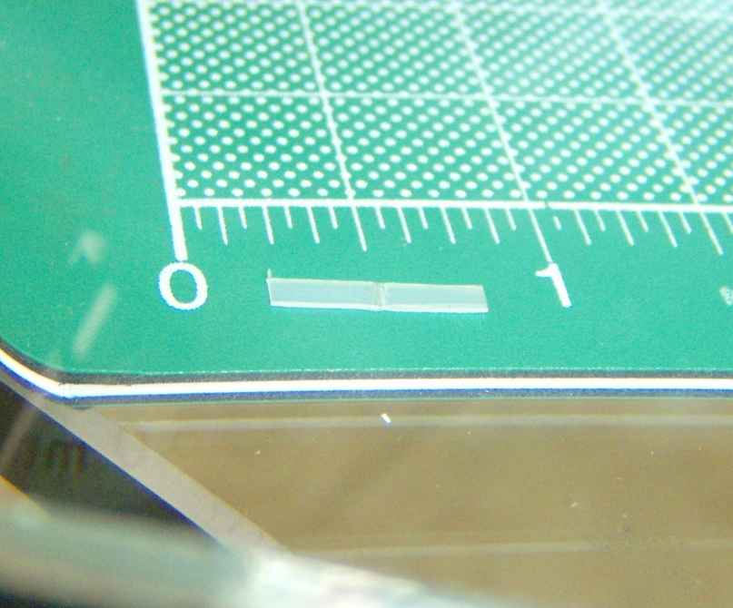

Hello Dave
                       I thought you might like to try using nylon hinges on the bipe. I just finished installing some on the little bipe. I bought some nylon hinge material from SIG. I used 30 min epoxy sparingly being careful not to get the epoxy in the dimple. I glued the hinges to the stab and once it was dry then I installed the elevator.  I used a cotton swab and alcohol to clean around.
            https://sigmfg.com/collections/hinges/products/sig-nylon-hinge-material?variant=235962368009
        The one I used is their .010 x 1/2 inch x 24 inches.  I cut some 3/32 wide pieces and then using a set of round tip craftsman pliers I made a dimple to thin the material and make it easy to bend. I like my controls to be easy to move. In this little models you can`t have stiff elevators. The dimple doesn`t weaken the material. I used two pliers to pull on one piece and all it does is stretch but will not break. here are some pics.

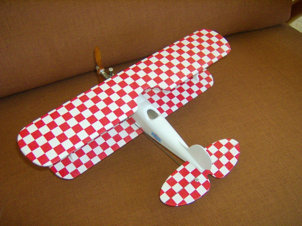

            Well I`m done with building the Little Bipe since the engine is brand new I need to do break in. Here are some pictures of how it came out.

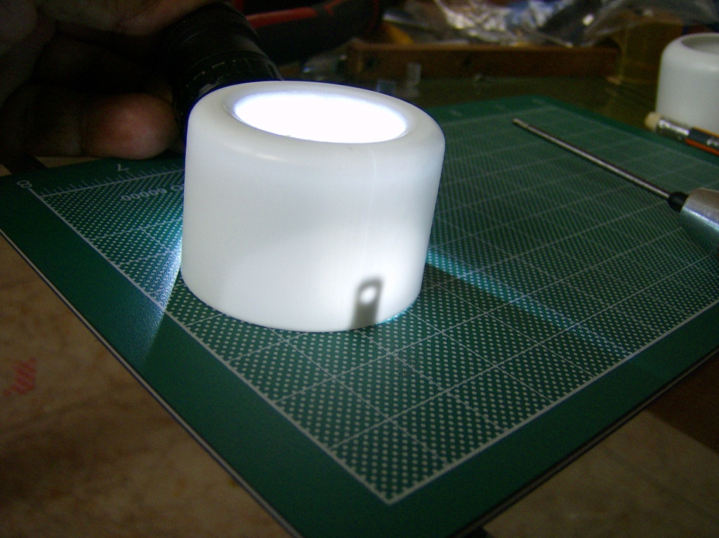

« Reply #35 on: July 22, 2022, 06:21:04 PM »
Hello guys

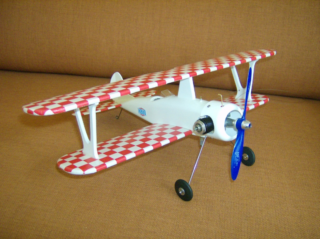

                     Thanks for all the kind comments about the Little Bipe. I have to do other things but  I working on getting the engine ready to do break in.

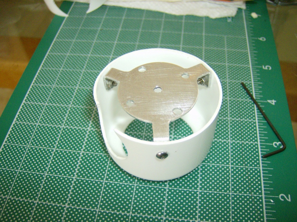

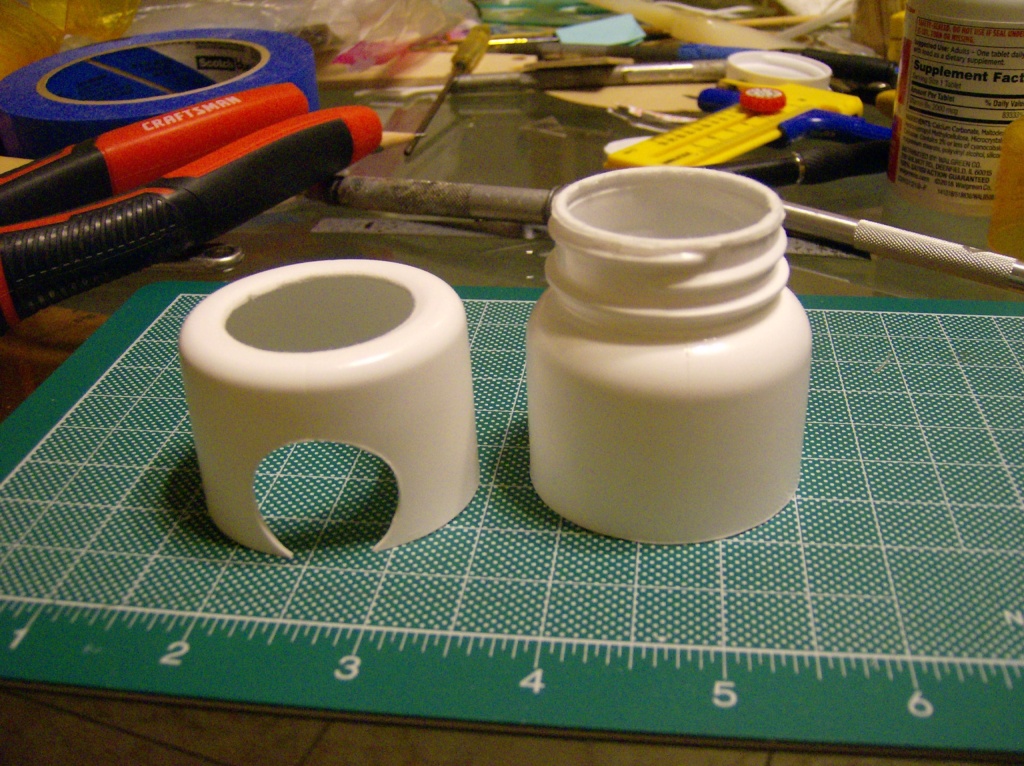

I read Larry Renger comment about a cowling and this morning I made one using a B-12 vitamin bottle from walgreens. I measured and it came out at just the right size. The best part was I didn`t have to paint it to match the fuse. I had to make an aluminum bracket to mount the cowling but still needs work. I also need to extend the needle valve and make a hole for it in the cowling. I placed the cowling on the plane to see how it looks. I`m not planing to use it when I do the first few flights and then if everything comes out right I will try it. I don`t want the extra drag from the cowling since I don`t know how well the OK Cub .049A is going to pull it. here are pics.
« Reply #38 on: July 31, 2022, 08:52:21 AM »
Truly beautiful! Good show.
 Hello Larry
                      Thanks, I really appreciate your comments. After I made the cowling using the bottom of the vitamin pill bottle I realized that I could have a more aerodynamic cowling cutting the neck of the bottle which gave me a more gentle curve to the front of the cowling. I made a bracket out of .040 inch soft aluminum to attach it clamping it between the engine and firewall. I drilled the mounting holes on the cowling using a flashlight to shine light on the inside so I could see where to drill the hole. After drilling the first hole I bolted the bracket to the cowling to hold alignment while I drilled the other two holes. This little cowling could be used on other Scientific hollow logs or profiles like scientific Beechcraft staggerwing bipe and F3F wilcat Profile. Here are the pics.

               I`m posting the drawings I made on a 8.5 x 11 sheet of paper of the Little Bipe in hope that you guys can make one if you desire.Top wing wingspan 16 inches,bottom wing 14 inches. Please let me know how it comes out at your end when you print it.Thanks.
P.s.  I downloaded the drawings from this thread and they came out OK.

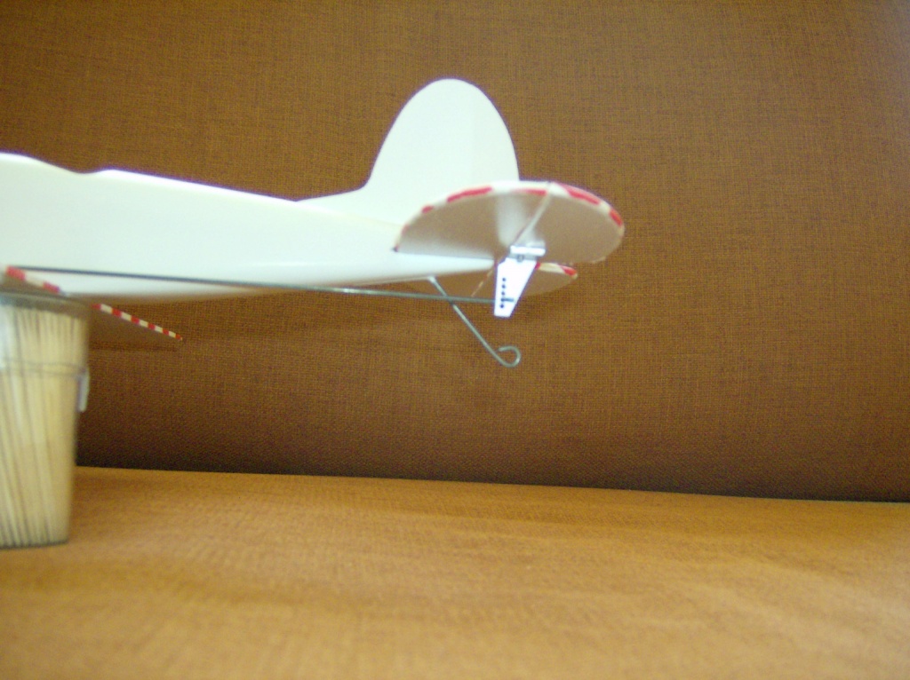

                                      I`m posting this last photo of the building of the bipe. I was gluing The top wing and to check the alignment in relation to the stabilator and bottom wing I used some sight gauges that I removed from a torpedo level and had glued to 1/64 plywood. In the photo you can see that I needed to adjust the Top wing position to get it level with the other flying surfaces. I had the plane inverted to use the flat side of the wings to place the sight gauges. I adjusted the wing since it was not glued yet and set it in place.
