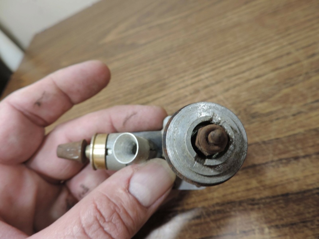

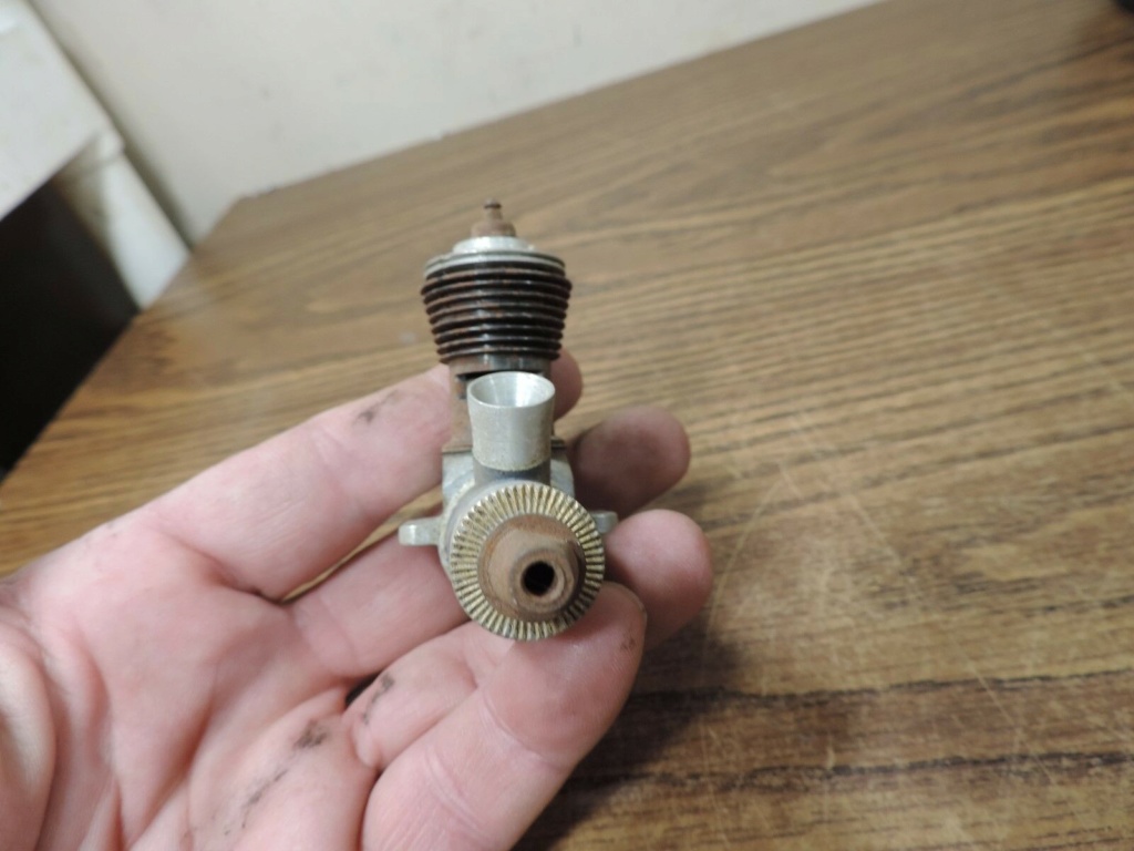

Five years ago a member of the Cox Engines Forum posted about a horribly abused Cox TD .15 for sale.  It looked like it had been sitting out in a field for about a decade.  I bid on it and got it for $11.
It sat in a baggie until late last year.  I disassembled it and started looking for rebuild parts.  I had looked at what it would cost to do it back in 2019, and it would have cost $85 in parts.  I put it off for later, but now there are not enough parts to buy online available to rebuild it.  So, I decided to give it the same treatment that I did on the bladder conversions I previously posted here on .049 and .09 Medallions.
It was cheap and easy, as I only had to buy a $13 Medallion .15 venturi body from MECOA.  I used a normal Cox .049 product engine NVA I had, soldered into a brass tube the same as on the previous conversions.  I was hoping to get somewhere between Medallion and TD.15 RPMs as this is a hybrid.  Initially I was only getting 11,400 RPM.  Instruction sheets for the TD and Medallion say that on an 8x4 prop I should get 13.8K on a Medallion and 15.7K on a TD.  I opened up the throat of the venturi and ran it today.  I am now getting 16.4K on the 8x4 prop.  I’m calling it good.
So, if you ever find yourself with a TD.15 and no venturi parts, this is one  way to go.

Motorman, that's a Master Airscrew 8x4 prop. The Cox instruction sheets listed speeds for four props: 7x6, 8x3, 8x4, and 9x3.  I figured I'd pick a prop in the middle for testing, and I didn't have an 8x3, so the MA 8x4 it was.
