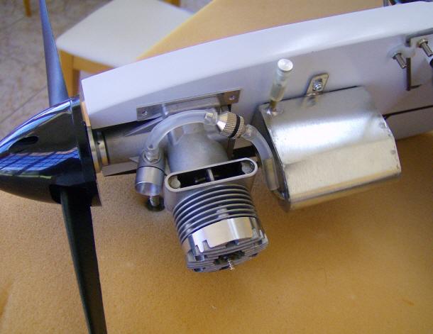

  A search shows many ways to construct
metal tanks but here's my low energy,
low investment technique.
  I get good results with Uniflow Mail Box tanks.
They run steady, and give a subtle warning
with a (usually) clean shut down.
The rounded end is easier to make than a wedge
and the Volume is easy to calculate.
There are instant Cylinder Volume Calculators.
Just Google it.
Calculate volume for half a cylinder added to a box.

  Finished!
  OK, we have all seen better and my soldering
isn't brilliant but the advantage of having the
exact tank for a plane is golden.
I like shallow tanks that work well inverted
and this tank is shallow.
  Making the end caps this way means that there
usually isn't any debris inside after it's sealed up.
I flush the tank with lacquer thinner before use
and I ALWAYS use a filter on any metal tank.
  The Cookie tin metal doesn't seem to rust much
but for long term storage I always shoot in a
little after run oil and I keep them plugged.
  This tank holds 6.5 Oz and weighs 2.2 oz
which is a little heavier than a plastic equivalent
but still pretty good.
Cheers! - K.

                         I also like to make my own tanks using a gallon can that I buy at a friends Auto paint store. I have saved keith`s and your posted information in my docs.Thanks for posting guys.
Offline goozgog
  • Posts: 553
Re: Metal Tank Making
« Reply #16 on: February 03, 2023, 10:07:38 AM »
Juan. That is TIDY!  y1
Keith Morgan
« Reply #17 on: February 04, 2023, 06:57:06 PM »
            Hello Keith
                                  Thanks. I built it in 2008 from a Larry Richards Sterling F-94 Starfire kit,the wood was excellent too bad he is not making kits anymore.
  • Posts: 2115
« Reply #18 on: February 05, 2023, 05:23:07 PM »
Hello Juan!
That is a really nice plane, my friend. And a custom tank built right off the kit plans. Sweet!
I have not seen a tank geometry that combined a deep outboard wedge with the big radius, making it halfway out to Goozy's mailbox.

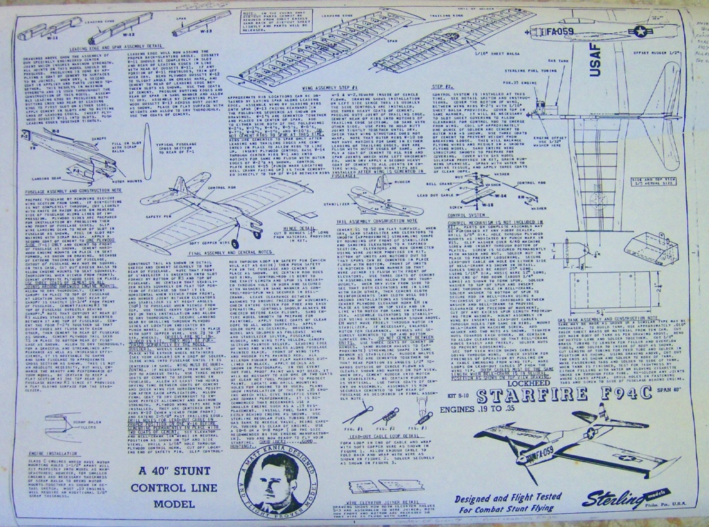

                                                  I wanted to replicate the tank on the plan for the looks on the plane. It was a challenge since I hadn`t made one like that before.
« Reply #21 on: February 06, 2023, 09:07:50 AM »
      I may still have some Acme brand tanks around here, some still in the box, if I haven't already  thrown them away. I used to use them in my early days of stunt, and noticed right away that they started to turn green and grow what i call "pickle relish" in them pretty quickly. SIG musty have had a warehouse full because they carried them in their catalog for quite a long time, but I didn't buy any from them. All mine came in junk boxes I acquired along the way.
    A neat coincidence is that Juan posted some nice photos of the model from the kit that some one was looking for the original kit instruction sheet for, and now I know what it looks like!!
 Hello Dan
                          Here is a picture of the instructions for the Sterling F-94C. In what forum was the guy asking for the instructions do you remember? I might be able to send him a picture he could enlarge and read the instructions.
  • Posts: 7567
« Reply #22 on: February 06, 2023, 05:33:46 PM »
   Hello Juan;
     It was over in the Classified section. Dalton Hammett has a kit , plus some parts tracings, but wanted the original instruction sheet to fill out his kit. I do believe he finally found the instruction sheet. I think I have the kit, but not sure how complete it is, not a big priority right now. The F-94 Starfire is a pretty cool looking jet and just catches my eye. Thanks for the offer though!! Much appreciated.
