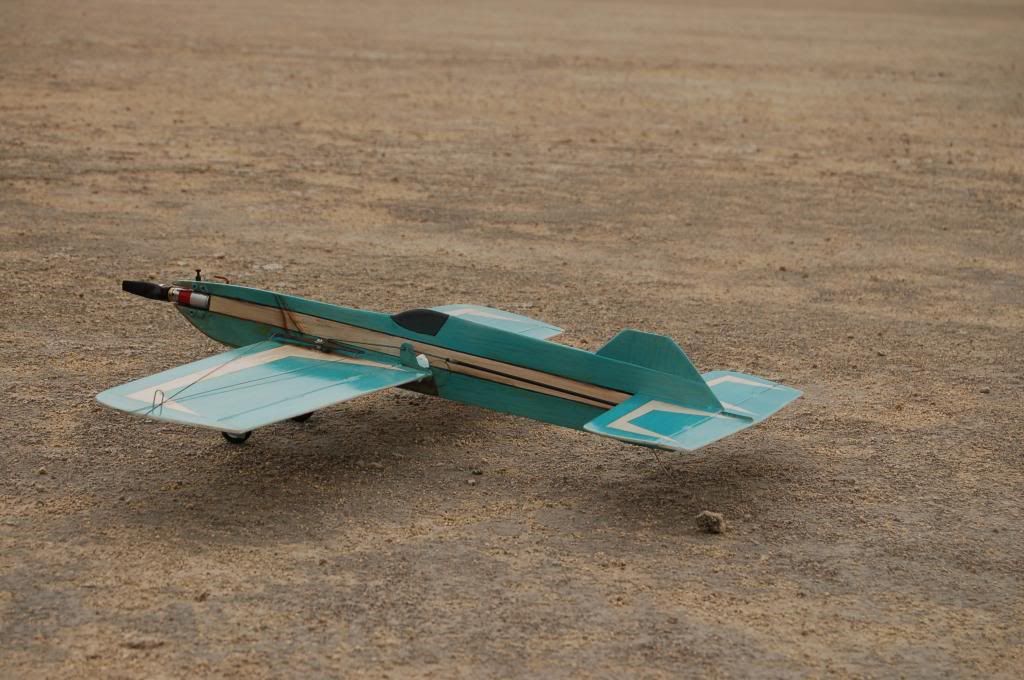

Hey guys, I just finished a flapped plank 1/2a stunter (tee dee 049 powered), which is going great, but it is screwing me into the ground a little.
First flights were with a MA 6x3 and it was moving, even on 40' lines, but had great line tension.
I then dropped to APC 5.5x2.5 and the speed was more managable, but broke that prop pretty quickly.
I had a rummage in my flight box and pulled out a APC 6x2, and while the speed was nice and slow, I had no line tension at all. I was still able to wing over and do most maneuvres, it felt very light and didn't instill much confidence.
I've now found another 5.5x2.5 and will carry on with that, but now I"m thinking as to whether I should go for more pitch (maybe a cut down 6x3) and cut a new longer set of lines.
I'm currently running around 40' spider wire.
Thoughts?

Hey, how about a photo and some specifications? I don't recall seeing a flapped plank stunter before.i
Offline Curare
  • Posts: 803
Re: Lap times, increase line length or drop some pitch?
« Reply #4 on: April 15, 2013, 09:46:43 PM »
There are, if you get bored look up the "yardstick" and "stunt wind"  Both are flapped plank wing stunters.
I started with similar moments to a white lightning, but decided I wanted flaps becuase my life isn't hard enough.
As it turns out it's a great little model. Span is 33" and I managed to jag the CG so it's about 25%. Considering the monstorous tail area I think you could almost run it back further!
Considering it's sort of become a reduced stunt wind, it's now nicknamed the stunt fart!

Hey I like it.
  • Posts: 6119
« Reply #6 on: April 17, 2013, 07:09:59 PM »
The plane looks great.

Good looking plane!  What is the fuse length and thickness and what is the wing thickness?
Offline Curare
  • Posts: 803
« Reply #10 on: April 19, 2013, 11:56:27 PM »
Ray, I would if I had any left!
John, wing is 1/8" medium sheet, and the fuselage is a little over 3/16 (5mm here in aus).
It's a bit wobbly, but it's light:D
If I do another I'll probably wedge a peice of 1/8" x 1/32" carbon in between the sheets to act as a spar. I'm also tempted to fit that to the TE of the stab to stiffen it up, but that's probaly overthinking things.
