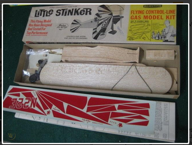

   Walt Musciano made more adolescent dreams come true
than a thousand prom dances. Most of the Scientific Kits
were easy enough to build and flew well enough that
they were worth cutting all those lawns for.
  When I opened the Little Stinker box, There, on top, was
the most beautiful and luxurious decal sheet that any
kit from anywhere ever came with. Sixteen inches of
crisp red sunburst, pinstriped numbers and little skunks.
When you're twelve, things like that are important,
as some might remember.

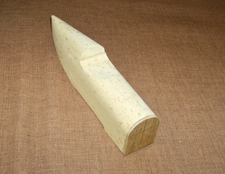

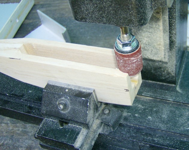

  I shaped the outside of the log before
I hollowed it on the drill press.
I just did the Shoeshine sanding technique
to round the front of the fuselage.
 This works well but I still
needed to use a circular gouge to thin the
shell.
  It's important to leave some thickness
behind the firewall and back at the rudder stock
since these are the stressed areas.

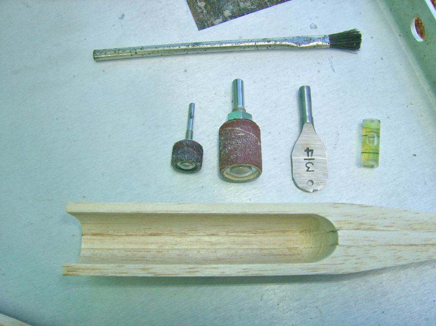

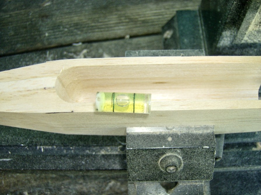

  Yes! Don't clamp it in the vice
too tight !
As the picture shows, I didn't
rely on the drill press to thin the
shell down to where I wanted it.
  When we were kids we would just
glue it together as supplied. We didn't
know any better but they flew OK
anyway.
   I'm walking a line between reproducing
the plane I built back then and building
the new one correctly.
  When I thinned the log, I left extra meat
behind the firewall and at the wing root.
« Last Edit: December 22, 2022, 05:39:06 AM by goozgog »

I think the hardest part of this build
is shaping the turtle deck / head rest.
It took two tries before it looked like
the original drawings.
  My mistake was rounding the top of the
entire log before I glued on the head rest
block. Ooops!
  My original plane had the cockpit open
and it collected oil and dirt.
This time I'm closing it in with 1/16 sheet.
Progress!
too tight !
anyway.

  Those decals are amazing ! I assume
they are reproductions. (?)
  I will be rendering the sunbursts with dope.
I was looking at a Scientific ad from back
in the day. A usual "log" kit was $1.69.
The Stinker kit was $2.95. The extra expense
was probably for the decal sheet.
  It was a flashy looking little plane !   y1
