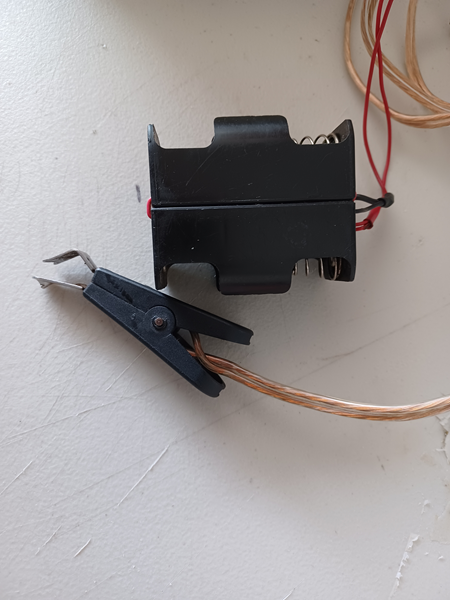

#6
I've used these for about 15 years.  You get four, and I wire two together in parallel with the holders cable tied back to back.  Works great.
Battery Holder
