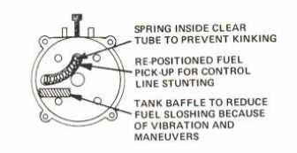

In the Main forum Dan McEntee posted about Larry Renger's AAM article in the For the Tenderfoot series where he talks about getting started in aerobatics.  In the article Larry talks about making a baffle in the Bee tank to prevent sloshing.
Has anyone done this?  How exactly did you make the baffle, as in what material and how did you affix it to the tank?  Larry, you in here?

I rec@ll using some thin ply. The baffle sits on top of the screw and is held down by the fuel tube.
