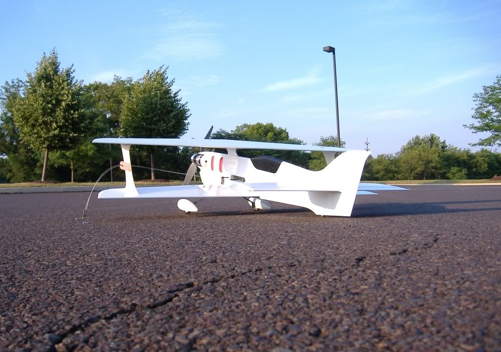

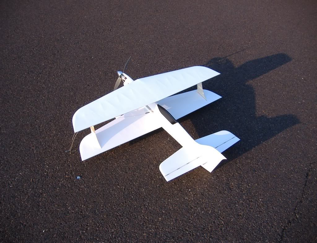

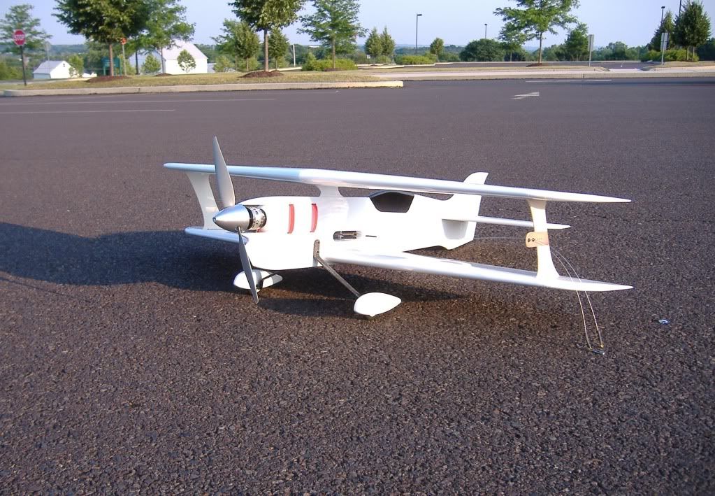

I would like to pursue another biplane. In the right conditions I think they can come close to the best monoplanes. I also believe they will always give something up in wind and turbulence. Maybe I will be proven wrong....
The picture below is my first biplane test bed I built over the winter of 2010/2011. I started from scratch (not influenced by any other design) and it's not a bad start. If things work out I would like to fly it in profile stunt, but weight has been an issue with the airfoil I chose. I've made some changes to it since the pictures were taken, but the current airframe is the limiting factor. I need to dedicate some time to it this spring and make some solid decisions so I can cut some wood for V.2.
From memory the specs are:
Span: 44"
Area: 630sq"
Weight: 50oz (with battery)
