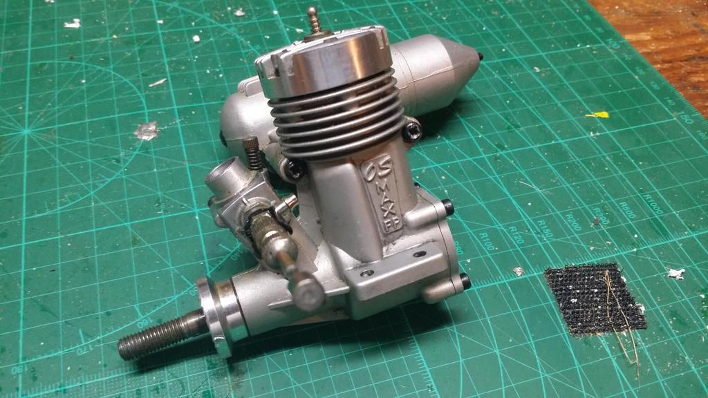

Offline Phil Spillman
  • Posts: 806
Re: Ringmaster with a OS.25
« Reply #14 on: July 24, 2016, 07:12:01 PM »
The picture is of an iron piston set up and in many circles, including my own experience, this is a preferred engine! You got the good one! I've run 9 X 4's, 10 X 4's, 9 X 5's wood and composite and the very best is the one YOU like the most! The iron piston versions should receive more oil for longer lives. I suggest you go with about a 25% total oil ration weighted more toward the castor oil side. A good mix an old friend and i settled on was 7% Nitro, 22% Castor oil and 3% Synthetic. just from my own experience with these combinations! This blend works quite well in the warmer months. I also support the the standard venturi needle valve assembly suggestion. Jim Lee of this forum could make one for you as well as many others who own laths.

New to me OS 25 FP arrived yesterday and it practically looks brand new.. Compression is super strong. Not a fan of the big muffler so I may look into a tongue muffler later on.
« Reply #19 on: July 28, 2016, 07:57:13 AM »
Please look on here for the "BBTU"
or the Brett Buck Tune Up
the stock muffler is part of the equation to make the engine perform, as is a 9x4 APC prop
I am not sure that I agree with the listed fuel selection either, I would refer to the BBTU instructions,
in fact Tim Westcott probably has a link to all the threads with it because he played in that arena
